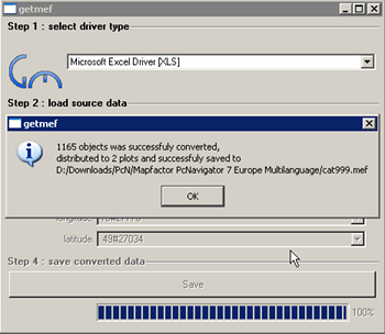

Yes, cat999.mef is only for radar. For other POIs use getmef.exe.
Re: PC Navigator 7
Příspěvek: # 14166Příspěvek Docent
I am sorry, my answer is wrong :oops: . Getmef.exe is for radars only, for other POIs use diggerQt.exe.

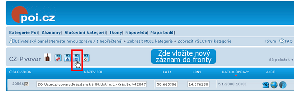

For example, Category 480 CZ-Pivovar (Brewery).
Save CSV File for iGO.
Open this CSV file in Excel and save it to xls file (e.g. CZ-pivovary.xls).

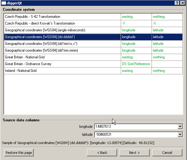

Now start diggerQt.exe and create new import CZ-Pivovar. Select Driver type Microsoft Excel Driver (XLS) and open file CZ-pivovary.xls.
Select Coordinate system and columns for longitude and latitude.
coordinate system.png (11.46 KiB) Zobrazeno 28786 x

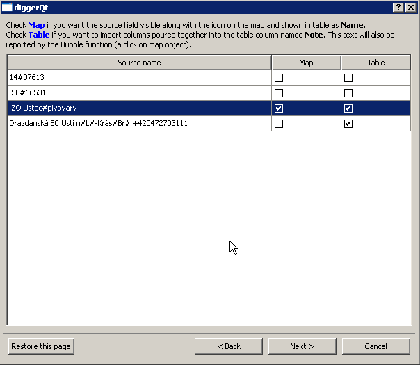

In next step, select source fields for map and table.
source fields.png (7.82 KiB) Zobrazeno 28787 x
Save configuration and run import. Now, in the directory wirh MapFactor PC Navigator on PC is "import" directory with "CZ-Pivovar" subdirectory. Copy "import" directory from PC to PDA-directory with map, in my PDA e.g. CR-TA on SD-Card.

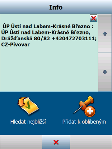

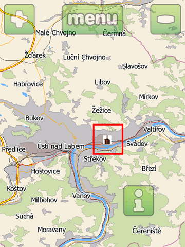

Now, brewery in "Ústí nad Labem" on the map:
brewery on the map.png (218.4 KiB) Zobrazeno 28798 x
brewery info.png (70.25 KiB) Zobrazeno 28829 x

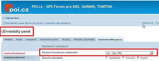

Without problems... Use getmef.exe and CSV file for iGO, than identical process with Excell.
Use not CSV converter for ov2 files, but direct CSV file for iGO from this site - User settings.
user settings.png (51.59 KiB) Zobrazeno 20467 x
